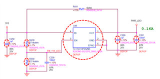

Hello Technocrats,
We use TLV74318PDQNR, please assist in reviewing the Schematic.
Vout = 1.8 A, I_max = 0.16 A, I_oc = 0.36 A,
  • Hi Gary,
    I have reviewed the schematic, and following are my comments:
    1. Almost all your components are marked as 'depopulated' including the LDO, please make sure this is what you are planning to do.
    2. R441: You currently have this marked to be populated. From schematic, it is a zero ohm resistor, and you will end up shorting input to output. I suggest you remove it. If you plan to use these as test points, I suggest using Test Points in schematic to avoid any confusion.
    Other than these, the capacitor values and the voltages seem to align with recommendations on the datasheet.
    Bobby
  • Hello Bobby,
    Thank you for your response and suggestion.
