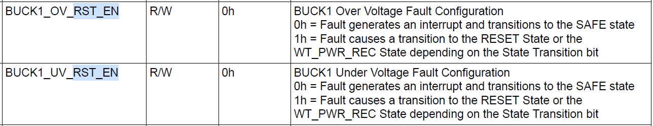

As per below statement, in Safety manual page number : 4 (fault reporting)
" Warning faults class enters the safe state and pulls down the nINT pin"
Can I turn off the PMIC for all warning Faults it detects rather than transmitting them via the error pin  ??
