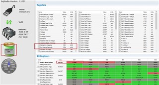

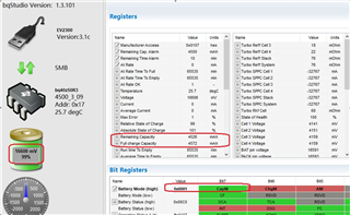

When we recently read battery information, we wanted to read capacity in the form of cWh, and the results were very different. Please help analyze what happened? Thanks a lot
We change the 0x0F RemainingCapacity() == 1
use BQstudio read the cWh value.it is not correct.
But when we read mAh ,value is correct
could you give me some suggestion?
