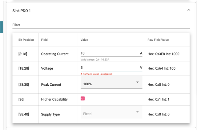

  • Thanks for the suggestion. The board we manufactured does not contain a programmable microcontroller attached to the I2C bus of the TPS. So, it seems like I am out of luck? Can I remove all but one sink PDO to force negotiation to fail if the source doesn't support 20V? In the configuration GUI it doesn't appear to be possible to edit the voltage of the first PDO to anything other than 5V.
    I will definitely keep the TPS25751 in mind for future revisions of the board.
  • Another idea: Since the current (only) of the first PDO is configurable, will setting the required current to something silly like 10A prevent that PDO from ever being successfully negotiated? This way I can effectively force only the second high voltage PDO to be used.
  • Hi Vincent,
    The first Source and Sink PDOs for all compliant PD devices (across all manufacturers) will always be 5V, this is to ensure any connection can start at a safe 5V before negotiating any higher voltage contract if applicable.
    Setting 10A for source PDO1 might not have any effect, while no source devices out there will be capable of supplying said contract TPS25750 will always request for the highest power available from the source, even if it's only 5V (if that is the highest capability the source can provide). The current limit is determined by the source depending on their capabilities.
    It might  be possible to do some discrete circuit logic to only enable the DCDC EN pin if VBUS is at 20V and using GPIO event "AttachedAsSink", however the best method would still be to use TPS25751 with the Capability Mismatch feature to allow the PD to automatically disable the power path if the configured minimum power requirement is not met.
