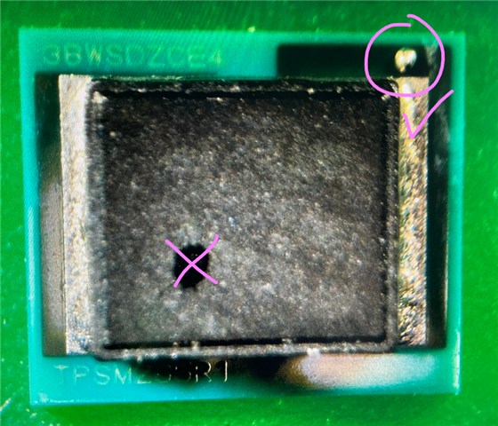

TPSM265R1: TPSM265R1 black dot on inductor and pin 1 marking
Part Number: TPSM265R1
During the manual soldering of prototypes utilizing the TPSM265R1 component, I discovered (the hard way) that the large black marking on the inductor does not correspond to pin 1. Furthermore, the marking appears upside-down when actual pin 1 designation is positioned on the bottom-left corner.
