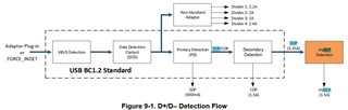

On the data sheet of the component is showed:
where is reported a DCP with 3,25A capability but the BC1.2 standard the max current is 1,5A; can you explain ?

  • Hi Stefano,
    CDP does not complete unless the USB host enumerates immediately after CDP detection.  If  IINDPM=3.25A is too high after DCP detect then you can use ILIM_HIZ resistors to clamp IINDPM to 1.5A.
    Jeff
  • Hi Jeff,
    ok then tf the BQ detect a DCM, my host rewrite the current limit at 1,5A.
