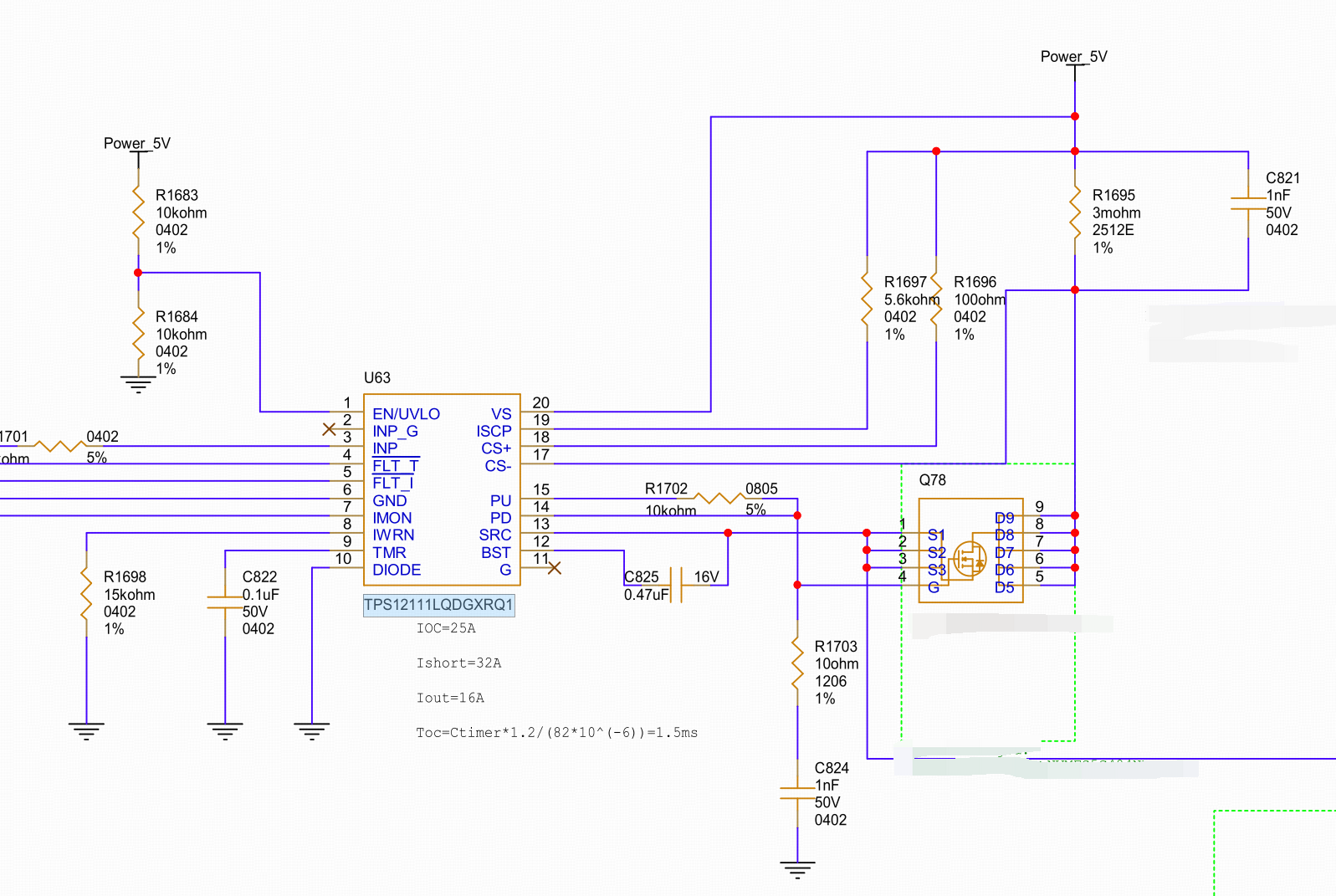

TPS1211-Q1: TPS12111LQDGXRQ1 can support short to battery?
Part Number: TPS1211-Q1
Hi TI
does TPS12111LQDGXRQ1 support short to battery?
