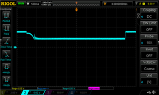

Once the IC is damaged, I can see on an Oscilloscope the output (VSYS) operates fine for about 10 seconds with a small load (100mA) however, slowly falls from its programmed regulated output voltage (~7.4V) across a few seconds after this point, until it reaches around 3V, ripples and then completely dies and there is no more output.
After this, if I turn off VBAT wait a couple of seconds and turn it back on, the above occurs again instantly. If I wait a few minutes, then it'll operate fine for 10 seconds again and then die. It's happened on 3 IC's now...

This is a close up of reference CH2 which is VSYS, once a load is applied after 10 seconds it drops to this
This is CH2, first outputting 7.4V from VSYS, with a load of 150mA for a few seconds, then it drops and crashes, then when the load is released it bounces back to a stable 7.4V output. When I replace the IC there is no longer this issue, so I know it’s not the load.

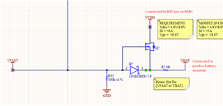

  • Actually, another reason might be because I have a P-Channel MOSFET between BAT pin on the BMIC and the positive battery terminal on the battery. This was added so we could connect a different BMIC (VFAST) to charge the battery at a faster rate than what this IC offers. The idea was, when there was a voltage present on VFAST it would disconnect the battery from the BQ25792.
    Although when testing VFAST isn't present perhaps the P-Channel is causing an issue with how the BMIC reads the battery...
  • I can confirm bypassing this MOSFET, the BMIC now works as expected. If possible it would be good to understand why the BMIC doesn't like the MOSFET between the BAT pin and the positive of the battery. Capacitance? Resistance?
  • HI Michael,

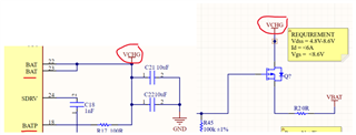

    The charger regulates the voltage at BATP pin not BAT.  I recommend back to back FETs so that the there is no current path through a body diode.
    Jeff
  • Sorry, I do have it wired to BATP as well (shown below). Thanks for your advice I will attempt back to back FETs as recommended and will click resolved should it work! Thanks again for your support
