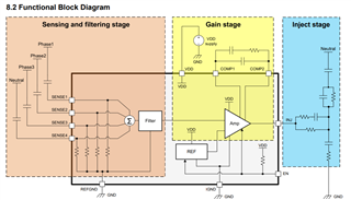

(1) Is TPSF12C3 possible to use for high voltage, high current applications as long as the common mode voltage (SENSE1, SENSE2, SENSE3, SENSE4 to REFGND) is within ±5V?
(For example, three-phase square waves of 0V to several hundred V, several hundred Arms)
(2) I think the TPSF12C3 is a voltage detection, current compensation type VSCI.
Does the current actually measure in the detection part of the circuit?
Are the resistors between Sensex and REFGND in the sensing and filtering stage( in the detection part of the datasheet p9 8.2 Functional Block Diagram) a shunt resistor?

    1.  Yes, it is possible to use TPSF12C3 for high voltage, high current applications as long as the common mode voltage (SENSE1, SENSE2, SENSE3, SENSE4 to REFGND) is within ±5V. You can refer to the datasheet absolute maximum ratings table for more details.
    2. Yes, it is a voltage sense current inject architecture. The resistors between Sensex and REFGND in the sensing and filtering stage are shunt resistors. But they are not accessible as they are within the IC.

    (1)You mentioned that the resistor between SENSEX and REFGND is a shunt resistor.
    I understand that in the Σ block after the voltage is converted by the shunt resistor, the current value between GND and each SENSE is added as a voltage, and the added current value is returned to the three phases. Does my understanding correct?
    (2)I think that when CY1, CY2, and CY3 in the Passive filter circuit in Figure 8-1 on page 10 of the TPSF12C3 data sheet are not connected to earth, the potential changes stepwise in the range of the input DC voltage of the 3-phase AC supply. (For example, if DC600V is input, it changes in steps of 200V in the range of ±300V.)
    CSEN3, CSEN2, and CSEN1 in the Active filter circuit are also connected to earth in the IC, so is it correct to assume that there is almost no potential fluctuation (within ±5V)?
    (3)According to the datasheet P6., the INJ current at linearity limits is ±80mA. When a CM current of more than ±80mA, can we assume that the noise reduction effect will decrease?

    1. The sense capacitor along with the shunt resistor acts as a high pass filter and then it goes through the Σ block and then to the Filter stage.
    2. Yes, CSEN3, CSEN2, and CSEN1 in the Active filter circuit are connected to earth in the IC, so it is safe to assume that there is almost no potential fluctuation (within ±5V).
    3. Yes that's true, as the INJ current at linearity limits is ±80mA. When a CM current of more than ±80mA, the noise reduction effect will decrease.
    4. could you please also refer to white paper in the product link (TPSF12C3 data sheet, product information and support | TI.com). It has more information
