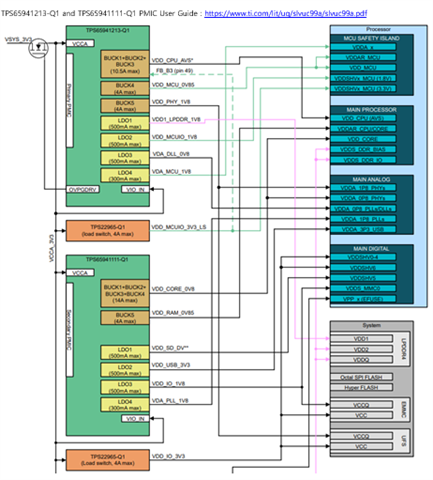

Hi TPS6594 Champ !
My customer would use TPS65941111RWERQ1  &  TPS65941213RWERQ1  for TDA4VM based Surround View Monitor Project.
Could you please explain the configurations details of the two PMICs?
Thanks.
Jack
  • Hi Jack,
    The link shown at the top of the image you attached, www.ti.com/lit/pdf/slvuc99a is to the PMIC User's Guide for the TPS65941213-Q1 and TPS65941111-Q1: this document describes the configuration of these devices for use with J721E/TDA4VM. It includes more information in section 5 about the NVM settings and section 6 about the PFSM settings, for these devices. Let us know if there's more information you are not finding in this document - I hope this helps!
