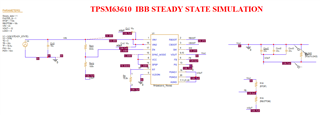

Hi Team,

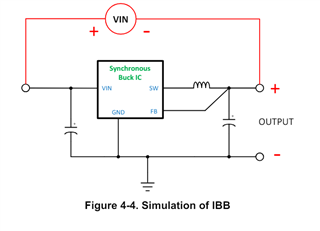

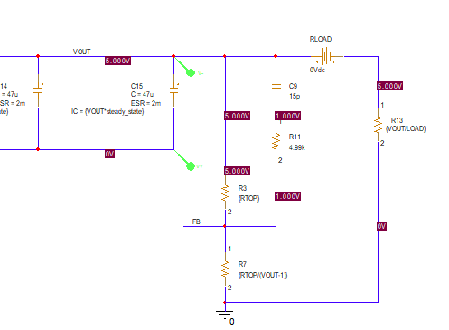

I am investigating the TPSM63610 and am trying to simulate the Inverting Buck-Boost capabilities of the part through the example circuit shown in section 8.2.2 of the datasheet. However, the outputs of the simulation do not match what I am expecting to see. Could you verify whether the PSPICE model is capable of supporting an IBB configuration for the TPSM63610. And if so, could you verify that the circuit I have below is correct?
