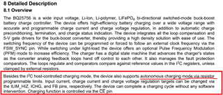

  • 1. the above snipped  i added from BQ25756 Datasheet, what are the Default values if we set REG_RST enable and,
    2.To confirm, does using REG_RST to reset the registers and relying on the resistor values on ILIM_HIZ, ICHG, and FB pins effectively enable what could be considered 'autonomous charging mode' on the BQ25756?
    3. in above picture using this register we can disable watchdog timer and after disable by set 00 values to the register how to we enable watchdog timer again ?
    4. Autonomous Charging mode and Autonomous Charging Cycle both are same if its not same means how to enable that ?
  • Hello Sankar,
    1. You can check the register map in the datasheet for the default values if EN_RST is enabled.
    2. Yes, that is correct.
    3. You can just set the watchdog timer to work again. Just write 01 or 11 or some other value.
    4. Where do you see these in the datasheet. These should both be the same modes.
