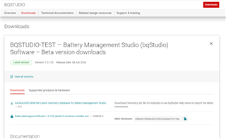

BQSTUDIO: Chemistry updates 1092 and 1095 break BQStudio 1.3.124
Part Number: BQSTUDIO
After attempting to update the chemistry files in my BQStudio, the entire Chemistry Tab went blank.
After some attempts I have seen the following
ChemUpdate1092.zip and ChemUpdate1095.zip break BQStudio. ChemUpdate1089.zip works correctly.
Some further investigation suggests that the problem lies in the file chemdat6, which I guess is corrupted. Replacing chemdat6 in 1095 with one from 1089 makes it work in BQStudio.
Please issue a fix!
