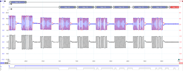

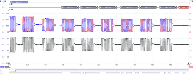

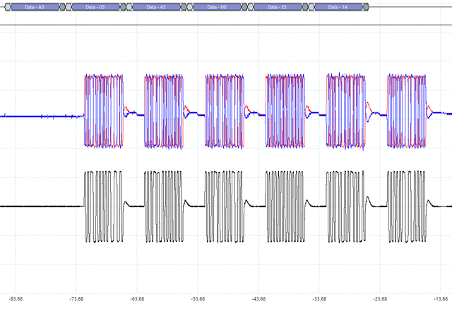

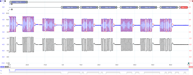

The recieved data is also not stable and changes bits every few seconds.Here are 3 different instences of this:

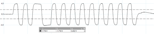

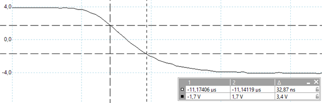

Possible signal quality issues have been ruled out so far, as seen in screenshots. Also rise and fall times are up to specification.We used the specification found in the application Note provided. We used the Application Note BQ79616-Q1 Daisy Chain Communications- figure 3.1 for reference as shown:
The sent data is as follows:
What is happening? Has anyone had this problem before? What data should we provide to make this clearer?

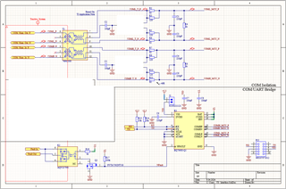

    What is the schematic of the BQ79600 board?

    I hope the schematic can be accessed to be read, I did white out irrelevant parts. The white box in the filter part hides TVS-diodes that caused signal quality issues and were therefor removed early on in testing.

    The schematic appears to be fine as the daisy chain has the recommend components. The CVDD pin has 100nF on your board instead of the datasheet's 220nF but I do not believe that this would cause the issue. To fully confirm that this is not an IC issue, could you unsolder the EVM's BQ79600 and replace it with the BQ79600 that the issue was observed on? And then test the EVM to see if the issue appears.
