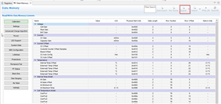

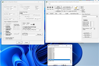

I would like to program a .srec file for the jauge BQ40Z50-R5 jauge through BqProduction but it's not working and i don't understand why.
Attached, you will find screenshots of the configuration of the jauge with BqStudio. => Registers - Data Memory.
Then, you will find screenshots of the version of BqProduction, Station Setup, Select device and VTI config.
To finish, you will find the log file when i try to push on START.
Fisrt of all, i don't know if i need to connect the ADVANCED-BQMTESTER board evaluation just for a programming ?
Then i don't find in the device list the good reference of the jauge BQ40Z50-R5. I need to uploaded an other version of BqProduction ?
AT the end, i have no information inside the log file, what is the issue ?

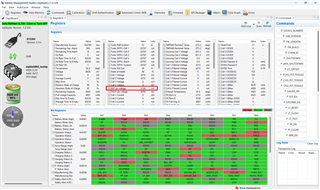

  • Hello Anthony,
    The finality of my project is to program a .srec file for the BQ40Z50-R5 gauge through BqProduction and without ADVANCED-BQMTESTER board.
    Yesterday, i find a solution to program my BQ40Z50-R5 gauge throught BqProduction but only with the ADVANCED-BQMTESTER board.
    And i seen a difference between the programing with BqStudio and i don't understand why.
    In the same condition and with the same .srec file, after a programing with BqStudio , i have VBAT = 8422V and BAT gain = 49107.
  • And with BqProduction i have VBAT = 4198V ant BAT gain = 24473.
  • So, first, i would like to understand why i haven't the same value for VBAT and VBAT Gain.
    And after, i would like to know the solution to program without the ADVANCED-BQMTESTER board.
    And after, i would like to know the solution to program without the ADVANCED-BQMTESTER board with BqProduction.

  • Hello Anthony,

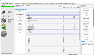

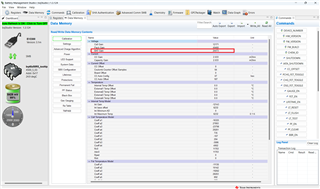

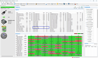

    I understand well that the VBAT Gain parameter is altered when you do a calibration but if i do only a programming with BqProduction in the same condition and with the same material compared with BqStudio this parameter is modify anyway.
    Moreover, when i do a voltage calibration with BqProduction in the same condition and with the same material compared with BqStudio, this parameter is modified and not just a little, he is multiplied by 2.
    BqStudio: VBAT=8.422V and BAT gain=49107.
    BqProduction: VBAT=4.198V and BAT gain=24473.
    I don't understand why ...
    Just to confirm, what is the true reading from the gauge? Is the calibration from bqStudio or bqProduction the correct reading?

  • Hello Anthony,
    The correct calibration and reading is on BqStudio via BqmTester.
    Yes, the BqmTester board is connect for the two software.
    I know that is necesary to do the calibration on 20 pieces but the value of calibration on BqProduction is too far compared by BqStudio.

  • Hello Anthony,
    Attached, you will find the .gg file.
    agl v1r4_0.gg.csv
  • Hi Nicolas,
    Thank you for sending the functional .gg file.
    Is it possible to share the .gg file of the gauge with the incorrect BAT calibration so we can compare the two?
    Anthony Baldino
  • Hello Anthony,
    Below you will find the .gg.csv file after programming by BqProduction.
    agl v1r4_0_FAIL.gg.csv
    I don't understand why but after configuring only a SRecord Programming in BqProduction, push Save Configuration and push Configure VTI, i execute a Start Test sequence and at the end of this sequence, after the srec programming message, a message Calibrating in progress appears.

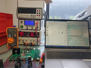

  • One precision concerning the wiring of my Tests with BqProduction, the calibrating board HP495, the probe MKST-3P-ALT-EV2300 and my Gauge BQ40Z50.
    I use only 2 elements so my wiring is:
    Calibration Board HP495 to Gauge Board
    - Pack- vers Pack-
    - BATT- vers 1N
    - CELL- vers 1N
    - CELL1+ vers 1P
    - CELL2+ vers 2P
    - SMbus vers SMBus
    Refi+ and Refi- vers Multimetre
    And i tryed with or without connexion between Pack+ gauge to CELL2+ with the same result.

    Based on this, I believe that most of these connections are correct, however I am slightly unclear of the orientation of these matches. If the left is the calibration board and the right is the gauge board, then that would confirm that the B- and 1N connections of the calibration board are going to 1N of the gauge board, which is correct. Can you please confirm this?
    Can you also confirm whether 4P and 3P are left floating, and the orientation of the PACK+?
    Anthony Baldino
  • Hello Anthony,
    Fisrt, i confirm B- and 1N of Calibration Board go to 1N of my Gauge.
    Next, on my gauge, VC4, VC3 and VC2 are connected together.
    On Calibration board HP495, 4P, 3P and P+ are floating.
    So, Pack+ of my gauge is not connecting to the Calibration Board HP495. is it normal ?

    My current idea of what is occurring is that the calibration board for some reason is not recognizing one of the two cells, hence why the VBAT and BAT Gain are exactly one half of what is being measured from bqStudio. While checking the .gg file for both the correct and failing situation, both had a DA Config representing that the correct amount of cells is being configured to the gauge, however I believe there is somewhere in the process that is changing this.
    When the voltage calibration is being done in bqProduction, is it being specified that there are only two cells being used?

    I don't found any parameter or configuration to precise who many cell we use in BqProduction with calibration board HP495.

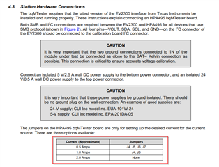

  • Hi Nicolas,
    Sorry for the delay, can you please tell me what the orientation of the current jumpers are on the calibration board and if any different orientation have been tried? If so, were there any differences in the VBAT parameter created by bqProduction?
    Anthony Baldino
  • Hi Anthony,
    I tried with the three config of current and i obtain the same result.
    In the 2 cases, i used the same configuration (Power supplies, Board calibration, SmBus probe, ...) because when you push on Configure VTI you have the voltages on Cell1, Cell2, Vbat, Vpack,... See pictures.

    No, the original firmware for bq40z50 gauge not been attempted because i need the last version of firmware to use some of the new parametres.
    So, if i understood well, the last solution to automate the programming and calibration of the BQ40z50 gauge which I have not yet tried is to do it on the command line but for this I need to develop a VI on Labview to communicate via the "MKS-SAI-001".
  • Hi Nicholas,
    I believe so, I will reference the differences between the data mapping of the original firmware and the bq40z50-R5 firmware see if there are differences that could be causing this.
