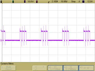

When the charging current drops below 300mA near full charge, it goes into burst mode.
Even though it is called burst mode, it oscillates for 10 seconds, then stops oscillating for 10 seconds, and repeats this.
The above phenomenon does not occur in the constant voltage mode of the electronic load.
What is the cause of this?

    I would like to ask about PFM mode.
    Currently, I have selected PFM mode, but the oscillation frequency does not slow down under light loads.
    It is close to burst mode, is that correct?

    I would like an answer to the PFM operation question I asked yesterday.
    Is it correct that the frequency will slow down?
    Currently, the oscillation frequency remains the same, but the rest period tends to become longer when the load becomes lighter.
    Best regards
    Waveform_20240606.pdfTPS55289-CALCULATION-TOOL-V1(20240605).xlsx
    In PFM mode, with light load, device will switch several cycle and stop switching for a while. The lighter the load, the longer stop switching time. The first waveform of your attached file is a normal PFM performance.
    This description is normal PFM mode behavior.
    But the second waveform looks strange since output current is oscillating. What load is consuming the current? Is there any control? Have you try to change R35 to 5k?
    About your description: "Even though it is called burst mode, it oscillates for 10 seconds, then stops oscillating for 10 seconds, and repeats this." Can you give me some waveform to explain it? Time scale should be longer.
