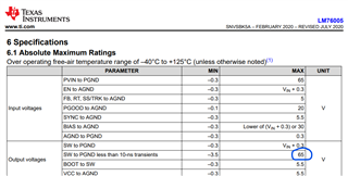

I am planning to use the LM76005 in an automotive design.
The end device can work as a 12 V or 24 V system and the load dump is already limited to a maximum of 58 volts with a diode in the vehicle.
In my opinion, the LM76005 should already be able to handle the requirements of ISO 16750. However, further modifications are needed to fulfil the requirements of ISO 7637-2.
The regulator may operate up to a maximum of 65V at the input. The vehicle's clamping diode clamps to a maximum of 58 volts. In order to be able to catch the bursts of ISO 7637-2, I would need a diode that only opens at greater than 58V and clamps at less than 65 volts. So far I have not been able to find one.
Does TI have any recommendations for this usecase?
Is another TI switching regulator perhaps more suitable?

    LM76005's maximum input voltage is 60V (not 65V) and the Abs max of the SW node is 65V.  The device might be permanently damaged if the SW node voltage exceeds 65V (due to a switching) during the load dump.
    -EL

  • Hello Dirk
    It is trickly because the minimum clamping voltage should be greater than 58V and the maximum clamping voltage should be less than 60V.
    • The regulator may operate up to a maximum of 65V at the input. ==> Please confirm if this is a mandatory requirement.
    • I would need a diode that only opens at greater than 58V and clamps at less than 65 volts ==> Please confirm the LM76005 should be enabled when the input voltage is greater than the 58V but less than 65V.
    -EL
