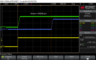

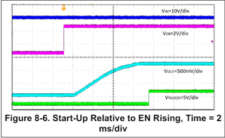

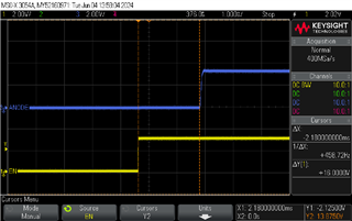

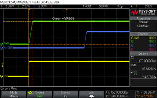

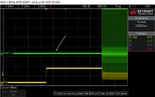

I am observing around 2ms delay from the time the EN signal is turned HIGH to the output voltage starting to ramp. I do not find any information regarding this in the datasheet. Could you help me with this?

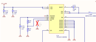

Circuit connections
1. VIn = 12V
2. Load is a 2.5V forward voltage drop LED with upto 5A
3. EN is controlled from microcontroller to turn on when needed.
In the attached waveform, yellow trace is enable signal, and blue trace is the output voltage. I am concerned about this 2ms delay
