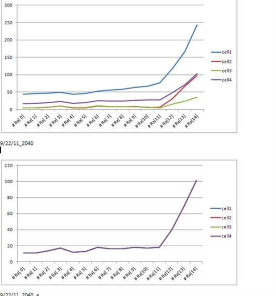

  • Hi Patrick,
    I plotted the Ra (Impendences)  from your aux files. They are qyitr varied from cell 1 to 4.
    Whar are the differences between 9/22/11_2040 and 9/22/11_2040_a aux files
    These variations in the cell impedences in addition to the incorrect cemID will cause the GG to have accuracy issues initially. The Gas Gauge will eventually learn the characteristics of your cell with enought charge and discharge cycles. However, since OCV updates are based on the OCV vs SOC table (chemID file), a wrong file will casue error in the GG.
    ChemID 100: represent a 2AHr Cell. Data from you ..ppcsv shows you are using a 10AHr Cell.
    The closet chemID for this type of cell is: 410 (LiFePO4).
    You will need to regenerate your .aux file with this chemID and select this in the .ppcsv file.
    Other option to get the chemistry right is to send the sells to us in Dallas for characterization.
