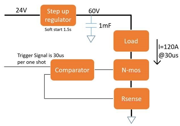

Hi sir

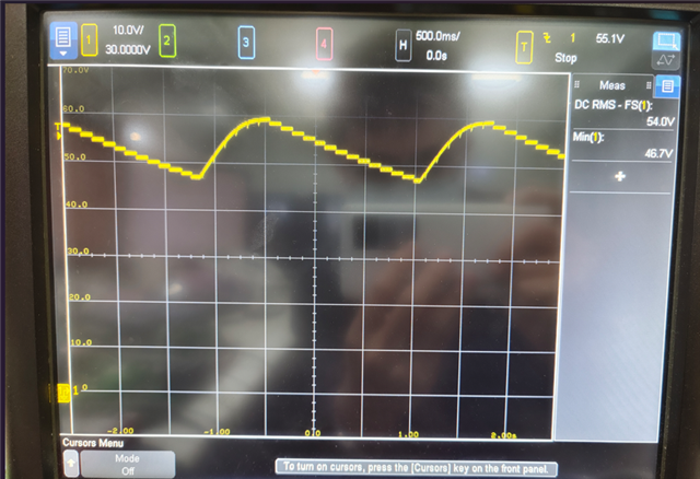

I need a boost circuit, so I choose the lm5158 for design, but when loading 0.3A~0.4A in 60v output built, the SS pin  down to 0
the IC shutdown, Please advise it,thanks

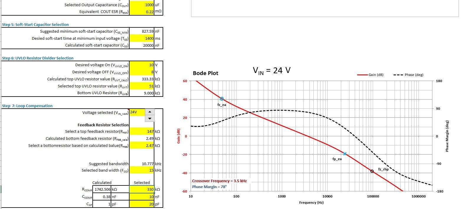

follow the TI tool: snvr511
parameter as below
LM5158EVM-BST
R5=51K
R12=10K
R14=21.1K
C25=22uF
C27=330pF
C26=15nF
R19=5.1K
R8=147K
R13=2.47K
L2=22uH/XAL5050-223MEC
Cout = 6.6uF
Cload = 1mF
