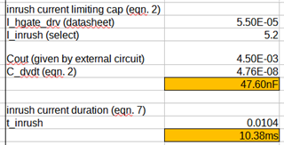

    I have filled in the calculator spreadsheet Steps 1&2. I wasn't quite sure about step 3. The tutorial that is linked in the spreadsheet shows different parameters, ie is a slightly different spreadsheet.
    There is a fair amount of capacitance to handle. V_MOTOR has another 3500uF on it (thus total about 4000uF). There is another 2200uF downstream of an LM317, whose current limit I expect to regulate the inrush current into that capacitor.
    On power up both LM74810 are off and the logic section is powered from VAUX via D3.
    I used Cdvdt = 10n and R=100R from the example in the datasheet
    but it seems I neglected the large amount of capacitance on the output.
    In what I hope are correct spreadsheet calculations, I can see that for the implemented circuit (Cdvdt=10nF), the inrush current is in the 20A range.
    Our application is not sensitive to how long it takes to turn on, so it appears I could easily make Cdvdt=47nF and reduce the inrush current to 5A.

  • Hi Maurius,
    1. Yes, your interpretation is correct. It can work with less amount of current.
    2. I would not recommend to go more than 0.1uF on CdvdT
    3. FET SOA margin and startup time are the only considerations
    4. 100ohms resistor limits the current into the CdvdT. Discharge of that cap also depends on that resistor. 100ohms is a good value.

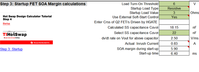

    5.  In step 3, you are expected to enter the details of the startup. As in, at what VOUT, you will start drawing load. What is the profile of load (resistive or constant current). This is an important step to know if your design will pass the startup. SOA margin is recommended to be >1.3.

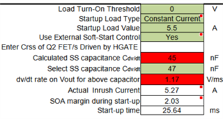

    5) I notice that for 'startup load value' your spreadsheet has 'Ohms', the one I downloaded has 'A'.
    Please see below. Firstly, why are the two cells red (seems like no matter what value they have, they remain red)? Secondly, why is the result for startup time almost twice the value when calculated using the datasheet eqns?

  • Hi Marius,
    2. When we cross 100nF of Cdvdt, we need an extra local discharge network. Usually, Cdvdt is discharged into the controller. But when the cap is 0.1uF, energy is higher and discharging it into IC can damage it.
    5. Spreadsheet has a changeable load type, constant current / resistive due to which the units are changed. Please share your calculator with me to review it.

    5) Please see attached spreadsheet for the implemented calculation.
