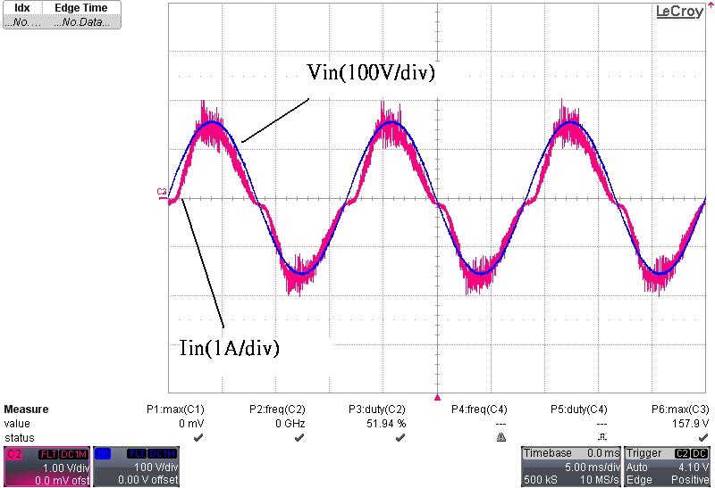

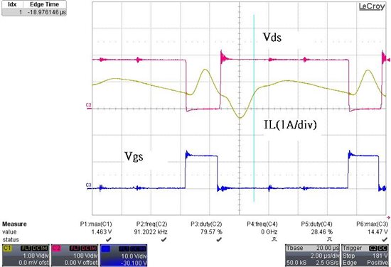

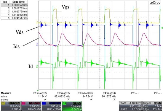

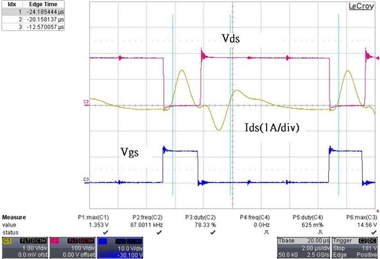

Hi,all.We are in process of designing PFE with UCC28070 integrated circuit.Power is 300W, 110V input voltage, 60HZ line frequency,180V Output, 100kHZ switch frequen.
180 ohm load test results, please refer to attached file for more information.Test results ucc28070 did not work.2577.eucc28070.zip
