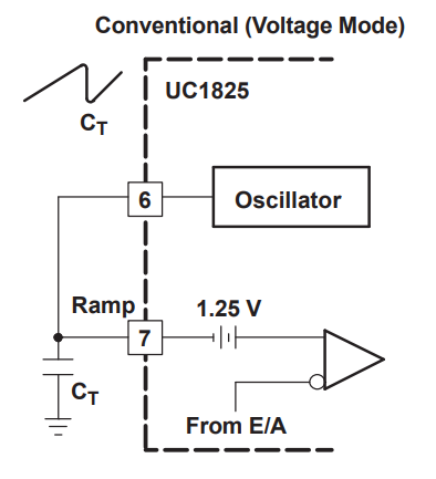

1. Customer would like to monitor a triangle wave that can be monitored via RAMP-pin in case of UC1825-SP. Are there anyways to moitor it?
They think the monitoring is required to design the system by understanding the relationships between the triangle wave, error amp output and Soft-start.
2. If the trianlge wave of the device has the 1.25V offset like UC1825-SP as below, could you tell what the voltage is?

    They try to use TPS7H5001 istead of UC1825. So in the past, they designed their board with UC1825 and observed the triangle wave of UC1825 for the designing. So now, they try to do the same approach to design the new board with TPS7H5001. Does this make sense?
    Please let me confrim below at first.
    1. They want to observe the triangle wave of TPS7H5001. Is it possible?
    Noriyuki Takahashi
  • Hey Noriyuki,
    The TPS7H5001-SP does not generate a triangle wave that the customer can observe.
