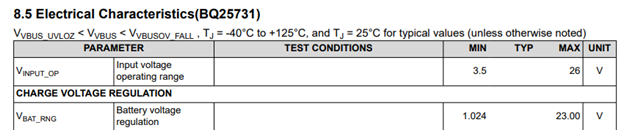

Hi team,
Although BQ25731 datasheet specify only support 5s battery, but I found battery voltage range can support up to 23V, so I think if I want to charge 6S LiFePo4 battery which max voltage only 21.6V, Can I use BQ25731 with setting Charge voltage register to 21.6V?
Amber
