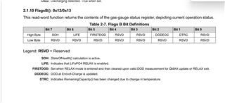

BQ34Z100-G1: Behavior of DTRC Bit in Flags B Register
Part Number: BQ34Z100-G1
The DTRC bit in the Flags B register indicates when a Remaining Capacity Adjustment is made due to a change in temperature. How does this bit set/clear correspond to the temperature changes? Does the bit toggle everytime an adjustment is made to RemCap, or does it only set? If it only sets, when does it clear after being set?
