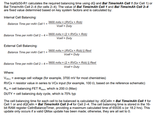

if anyone can please help me understand this cell balancing settings:
I've attached my Pack's setting which came from our supplier
it shows minimum RSOC to trigger cell balancing
First Question: looking at the settings i don't see one for Max RSOC cell balancing
Should this be included ???
Second question: What happens to the pack's cells outside of the Minimum and Maximum RSOC cell balancing issues

  • Hi Jonathan,
    The description for each of these registers can be found in section 14.4.12 of the bq40z50 TRM:
    https://www.ti.com/lit/pdf/sluubc1
    1) The minimum RSOC for Balancing is just a check to ensure the pack is not in a depleted state before cell balancing, so there is no need for a maximum value for this. Below is the process of checks the gauge makes during cell balancing.
    2) If the RSOC is less then the Min RSOC for Balancing, then the gauge will exit cell balancing.

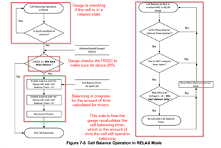

  • HI Anthony,
    1a. Is there a more descriptive format of the flow chart ,so it can facilitate understanding for me as there's lots of jargon?? :)
    1b. interesting information which actually sounds right from a design perspective as the pack should not have a max RSOC for balancing!!!
    but as per our supplier they said Max RSOC for balancing is 95%
    so basically from 20%~95% that's when the balancing would occur if all condition are met
    1c. you previously mentioned Cell balancing during relax mode ,and relax mode is defined as the time after charging or discharging that the gauge enables cell balancing
    What's cell balancing during Rest :)
    2. so below 20% Cell balancing will never occur?
    Thank you so much for bearing with me and answering so many of my questions!!!
    Jonathan Kabangu
  • Hi Jonathan,
    1. I do not believe that there is a more descriptive flow chart, however I have added annotations to the chart above to provide more simplicity. Please let me know if more detail is needed.
    "Cell Balancing at Rest" is the setting that needs to be set to allow the gauge to cell balance during relax. Rest is typically the period in relax where the cells are in a truly relaxed state. This is determined by the dV/dt condition being met.
    2. Correct. If the RSOC is below 20%, then the gauge will not conduct cell balancing.

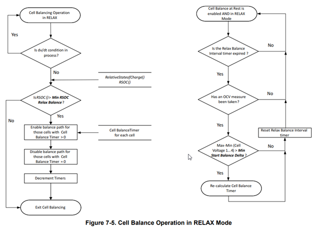

  • Hi Anthony,
    1.This is brilliant!!,i will expand on each block further :)
    • is the "Dv/Dt" the different in cell voltage over time ? if not what does it define?
    • what's a typical timer for cell balancing in others words how long do they need to spend in balancing for optimum pack performance , does this depend on the calculation and setting computed during relax ?
    • "enable balance path for those cells with balance timer >0 "does each cell have each timer ? & why does this timer need to be greater than 0?
    2.
    • "has an OCV measure been taken",Why are we measuring for Over cell voltage in this stage?
    • "max-min (cell voltage 1....4)>Min start balance delta?"what does part define?
    3.Cell balance at rest can be define as the cell balancing process once pack has entered relax and it's fully taking calculations?
    Jonathan Kabangu
  • Hi Jonathan,
    The dV/dt condition is the way the gauge determines if the cell is truly in a relaxed state. The condition is that the measured cell voltage cannot change by more then 4uV/s, to which I believe can be seen by the REST bit. I believe if this bit is set then the cell has cleared the condition.
    I do not believe there is a number for the typical timer since it relies on the cell voltage, however the formula to calculate this can be found below:
    The balance times are grouped for cell 1 and cell 2-4, and if that timer number is greater then 0, then the cell balancing path will open for that cell. Each cell will have an individual balancing path. The timer basically determines whether the cell needs to be balanced and for how long.
    OCV in this case stands for Open Current Voltage measurement, where the majority of our measurements for calculations take place. The max-min (cell voltage 1...4) > Min start balance delta is there to confirm that there is enough of a difference in the voltage between the individual cells for cell balancing to start.
    3. That is correct.
    Anthony Baldino

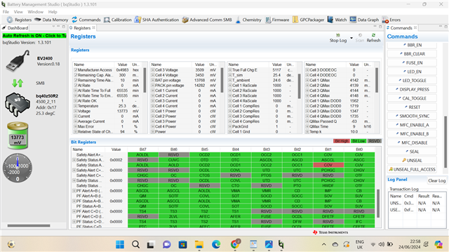

  • Hi Anthony,

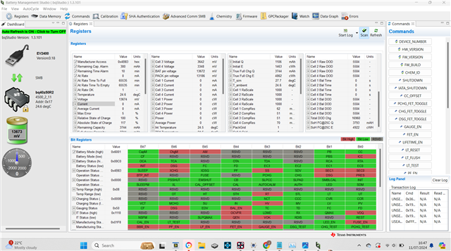

    1.I had a question in regards to the bits flags being raised in BQstudio
    logically we know 1=True/ON & 0=false/OFF
    in BQstudio there's the colour RED & GREEN
    Which one represents ON and which one represents OFF?
    2.
    What's the difference between CB&CB_EN bits?
    OCVFR=open circuit voltage flat region:what does this mean
    SO in this case since they're RED that means it's ENABLED???
    Here's a Screenshot for ref:
    3.currently our Min RSOC for balancing is 20%
    • Can we lowered this value let's say down to 5% and what will happen if we do change this value?
    Jonathan Kabangu
  • Hi Jonathan,
    Red = 1/ON
    Green = 0/OFF
    BAL_EN means that at that moment in time, cell balancing is possible, however it does not mean whether cell balancing is actively occurring. CB means whether cell balancing is actively occurring or not (active = 1).
    The meaning of OCVFR can be found below:
    Min RSOC for Balancing refers to what the minimum RSOC value needs to be before balancing can occur. This value can be set to whenever you want cell balancing to begin, including 5%.
    Anthony Baldino

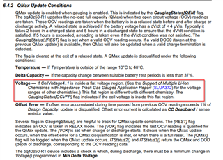

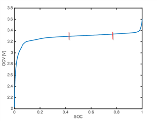

  • Hi Anthony,
    1.that paragraph does not define what's OCVFR is, i even clicked on the "SLUA372" link it does not quite expand on it,can you help out on this please :)
    in simplicity is an "open circuit voltage flat region" a good thing or bad
    2.Min RSOC for Balancing refers to what the minimum RSOC value needs to be before balancing can occur. This value can be set to whenever you want cell balancing to begin, including 5%.
    JK:our battery vendor told us the reason this is at 20% is because cell balancing process drains the battery capacity so setting it at 20% was a safe bet rather than 10% or 5% ,is this accurate?
    Jonathan Kabangu
  • Hi Jonathan,
    Being within the OCVFR is not a good thing, since when the gauge begins to take OCV measurements to update the Qmax parameter of the gauge, these measurements and calculations will be invalidated if the measured voltage is within this region. Where this region is based on the chemID being used. When the cell is at rest, this region should be avoided.
    This is correct. Having the parameter at 20% can protect the individual cells from becoming too low.
    Anthony Baldino
  • Hi Anthony,
    1.Being within the OCVFR is not a good thing, since when the gauge begins to take OCV measurements to update the Qmax parameter of the gauge, these measurements and calculations will be invalidated if the measured voltage is within this region. Where this region is based on the chemID being used. When the cell is at rest, this region should be avoided.
    JK:how do we avoid being in this flat region?
    is there any numerical value to watch out for that can indicate if we're in this region?

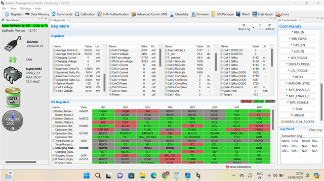

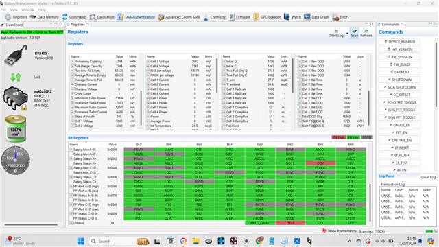

    2.
    in the screenshot above the CB,CB_EN & REST flags are all 1/ON
    2A. how's cell balancing possible whilst charging
    2B. When Pack is charging this is not longer in rest ? so how come the REST flag is raised

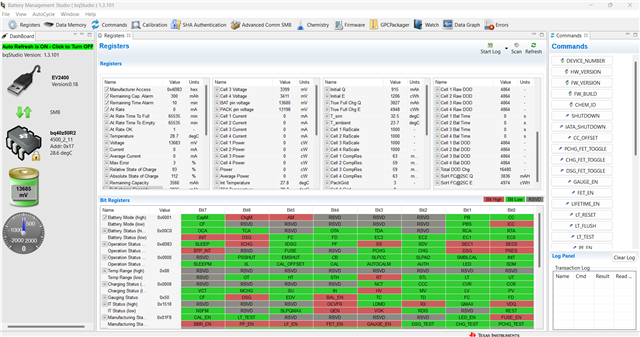

    Jonathan Kabangu
  • Hello Jonathan,
    Anthony will be out of town for a while, but I can continue to support you.
    To help answer this, can you tell me more about the typical application you will be using. Maybe even sharing a load profile that might be typical for your system.
    This depends greatly on the specific battery and chemistry.
    Please read this documentation to learn more about this: https://www.ti.com/lit/an/slva155/slva155.pdf
    Can you send me a log file of this occurring? Can you also send me the gg file for the gauge?
    Nick Richards
  • HI Nick,

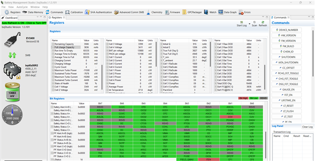

    3.another issue occurred whilst i tried getting the log for you ,the pack stopped charging and the pack enabled "COV" and stopped charging at 94%
    i'm guessing cell 3 hit COV ,i'd like to understand the root cause it was simply in charge then this happened
    furthermore how did this happen as CB & CB_EN is enabled meaning it's balancing cells but the
    log file:
    NL-02.log
    gg file:
    nl02gg.gg.csv
    Jonathan Kabangu
  • Hello Jonathan,
    • there's also a sleep mode of about 20~30mA until it detects an event then it goes up 450mA
    • I will try to get a load profile for you
    I took a look at your gg file and I think the dsg current threshold should be set lower to account for the sleep mode current of between 20-30mA. Right now the Dsg current threshold is set to 100mA and I think it will be best if that is set below 20mA. So maybe around 15mA.
    if you can get information and details on flat region values for Lifepo cells that will be appreciated
    I can not share specific voltage values of the flat region however I can share some knowledge in terms of estimating the flat region. LFP chemistry is much more difficult because it has a larger flat region compared to other chemistries.
    This is an example graph of the discharge profile for an LFP battery and the red lines is what I would consider to be an approximation of the flat region.
    The gauge implements passive cell balancing and it takes a while for the cells to become balanced since it uses very small current to balance the cells. If you want the cells to balance faster, then you will need to implement an active cell balancing circuit.

    how do we better control the Flat region so our pack never enters this section whilst taking measurements?
    The flat region is not something that can be altered, since it is defined by the chemID being used with the gauge.

  • Hi Anthony,
    it's set at 3750mV ,the recovery setting is implemented at 3500mV
    Question:See screenshot:
    gg file:01GU.gg.csv
    gg file:006k.gg.csv
    :Why's the COV triggering at 100%
    • i heard active balancing is much better and faster than passive ?
    Jonathan Kabangu
  • Hi Jonathan,
    I believe the COV protection is not clearing due to the Cell 3 voltage being higher then the recovery threshold. Also, I cannot pin point where the COV protection was triggered without a log file, however there could of been a moment where the COV protection threshold was passed by one of the cells.
    I believe that active balancing is more effective then passive.
    Anthony Baldino

    80 seconds minimum as per the documentation ! but this is not the case for our pack, did testing around this the longest it took was 20 minutes and the quickest time was 2 minutes ,any reason why this is happening
    i'll share with you the test report
    i'll also share with you the log for the for pack that took the
    FE002FJ00263240005Z-01:this pack met the condition the fastest
    005Z-01.log
    FE002FJ002632400AN-01:this pack took the longest:
    00AN-01.log
    FE002FJ002634301NL-02:this took 4 minutes
    01NL-01.log
    FE002FJ00263170005-01:this pack took 10 minutes
    0050-01.log
    Can you have a look at the logs and please help me understand why they all have different timing for VCT Setting
    Jonathan Kabangu
