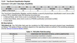

    For af standard PoE if the PSE contorller measures a current during classification that results in a Class 4 signature, the PSE will do 2-event classification which is enabled by default. If the PD that is being connected is an AT device, the PSE will negotiate AT unless otherwise set. If the far end PD being connected is AF standard PD, the PSE will only do 1-event classification.
    If you wish to limi the PSE to AF standard, you will need to configure register 21h (Two-Event Classification) to disable 2-event so you only do 1-event classification (which is AF standard).
