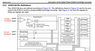

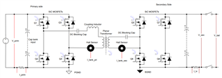

I'm looking for the "proper" digital controller to use for the application listed in the title (and described below) and was hoping to get more insight into whether or not the UCD3138 would be an adequate solution or if a C2000 series controller would be more appropriate.
The converter would consist of interleaved, bidirectional dual active bridge converters each controlled by an individual UCD3138 or C2000 MCU and operating with SPS modulation. The converters will operate with a phase shift between them in order to reduce ripple current seen by the common load. Further, the converters should be able to intelligently "shed" phases as a function of load in order to keep system efficiency high.
Also, does the UCD3138 have the capability to implement Extended Phase Shift modulation?
