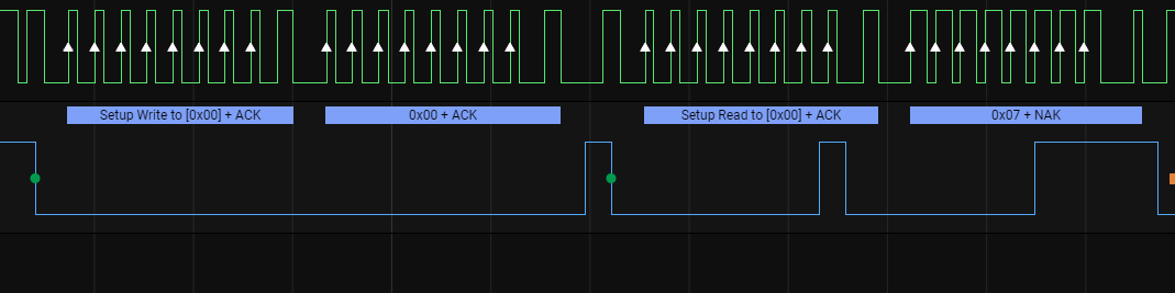

1. snap the I2C signal from PCIE x4:
Note: In red circle, there is some noise in when clock down.

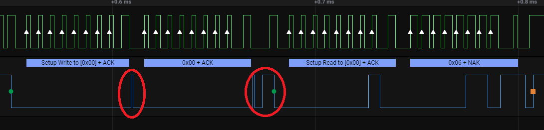

2. snap the I2C signal from PCIE x16:

  • Hi PoChun,
    It seems the register data is reporting back incorrectly...the noise may cause a read error, however the actual data waveform on the SDA is incorrect reporting from the PSE.
    This is the first time I have seen this, can you confirm the device does not chance between different I2C bus connection. Are you using same PSE IC or different IC?

  • Hi Brandon,
    Are you able to probe the I2C bus on the PCIe slot where the mis information is present and ensure the reading is the same using a prober?
    => we connect I2C bus and read the value as shown in first two pictures.
    Can you check this with a different host to confirm the data from the device is the same?
    => we insert the card into differenct host's PCIe x16 slot, the result is still the same wrong, 0x07.

  • Hi PoChun,
    My best guess without taking a look at the schematic or layout file:
    There is too much capacitance on the bus which is being caused from parsitic capacitance from long I2C traces. Too much capacitance can be either causing a slower slew rate since the cap is charging, causing the host to not capture the low to high transition resulting in miscommunication.
    It could also be the digital isolated + high capacitance depending on the logic level of the digital translator. Check which side of the digital isolator you are probing, if you have too much cap between isolator and PSE device, the low to high logic may be too slow, which then forces the output of the isolator on the host side to cause an issue.
    Without taking a look at the design specifically, it is hard to say what is the root cause of this. Normally I would recommend an ABA swap but since the device is not changing, there is something between the device and the host causing some miscommunication...
    Brandon
