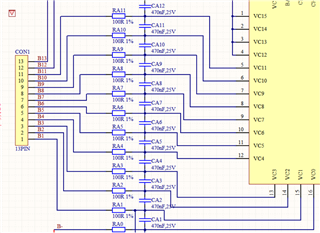

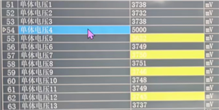

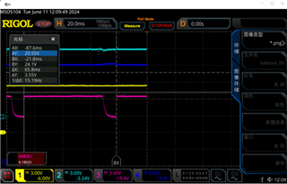

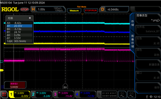

We have a problem about BQ76952, we choose the mcu as the host to control the balance, in the balancing time, we send the direct command to read the single cell voltage, the value of the single cell voltage is not right.
The single cell voltage would reach 5000mV, we do a restriction( The max value is lmited to 5000mV )
If we change the balance method( choose the passive cell balancing ), the value of the cell voltage is ok.
We have a quesion that if we choose the muc as the host, in the balancing time, the value we read from the afe is not stable. Should we stop to read the cell voltage at the balancing time?
