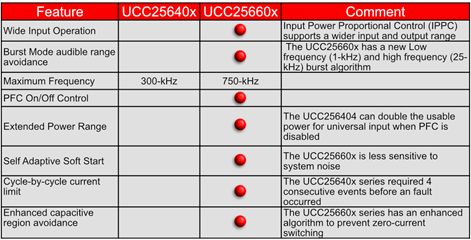

  • HI Bastian,
    You're welcome. Here is the link to the UCC256603
    Here is a simple comparison between the older and newer controller:
    I hope this answers your question.
