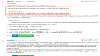

  • Hello Dominik,
    1, OCVTAKEN=1, is it indicative of successful Relax with OCV voltage <4uV/s?
    2, passedcharge=0, can it be used to determine that RELAX is successful and OCV voltage <4uV/s?
    #4: The gauge will set OCVTAKEN in Flags() after it detected stable voltage and calculated DOD0.

    1、OCVTAKEN=1,指示Relax成功,OCV电压<4uV/s吗?
    2、passedcharge=0,是否可以用于判断relax成功,OCV电压<4uV/s?
    3、加载FS文件后,在电池使用过程中,Qmax只需要更新过一次后,Fuelgauge就一直可以更新RA Table。这个理解对吗?
  • #1: Yes, but note that this is deferred so the gauge may have taken an OCV measurement earlier than when OCVTAKEN turns 1. But yes, OCVTAKEN means that the gauge qualified the voltage or that the time ran out (5 hours after relax, by default).
    #2: This means that the gauge used the OCV reading for a DOD0 update. So yes, this also indicates that the conditions were right (either stable voltage or timeout).
    #3: Yes, as long as Qmax is updated, the gauge will be able to update Ra (note that Ra updates still may be disabled by the gauge, if it calculates negative resistance values).
