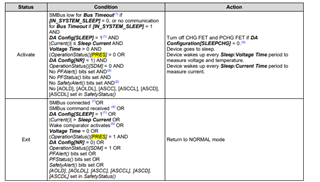

    And one more thing, sir whether we can  change  the BMS logic so within maybe 20 minutes of the PRES pin being released – we put the battery BMS into sleep mode and only wake it again when the PRES pin is triggered again ? Whether it is possible?

  • Hi Shubham,
    I wanted to ask, I see in your design that there is a R3 resistor that is a jumper. Is this jumper place on the board? Also, can you confirm measuring the pack pin to ensure no current is being pulled?
    I do not think this will be possible to implement based on the requirements to enter and exit sleep mode on the device.
