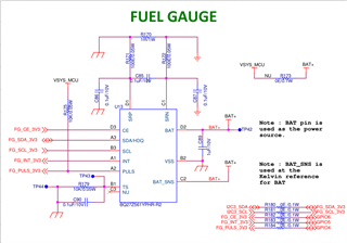

    I have log files from testing this with the custom board, where the EVM was not connected. The generated golden file works properly on the EVM.
     Below is the attached schematic of the custom board.
    Aachal
  • Hello Aachal,
    Are these log files from bqStudio? The one you sent us in your previous reply seemed to be a custom format.
    Your schematic seems alright.
