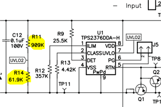

Hi there, i am using your TPS2376PW device with this configuration:
When i connect the Ethernet cable through an PoE inyector (TL-POE150S) i got this waveform measuring VDD-VSS:
I suspect there i am seeing the Detection voltage ( 3.8V) the classification voltage (7.8V) and the power delivery voltage (48V) .

    The "classification" voltage looks lower than it should be. I think it may be actually the detection voltage which is 2.8 -10 V.  CLASS pin only output correctly when VDD-VSS is higher than 10.2V.
    One thing I noticed is that you have a low UVLO resistance. In TPS2376HEVM, the total UVLO voltage divider resistance is ~1M Ohm so that the detection and classification signatures won't be influenced too much.
    For the system restarting. It may be related to loss of maintain power signature if you did not connect a load on the downstream. Please make sure if you have >10mA current flow from the PD interface.
    Diang
  • Solved: the system required a minimum power consumption to maintain the voltage.
