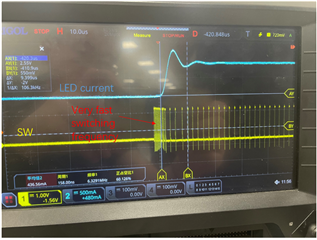

i have one question about the TPS92520 , Why is the frequency of the switching node very fast at the moment of startup?
What causes the switch node voltage like this? please help to explain this.
Operating condition:TPS92682+tps9250
TPS92680 output voltage:52v
tps92520 ouput voltage:2.6V  LED current:450mA. PWM duty:50%
please  refer to the following pciture.

    Sorry for the delay I was out of town.  This is not a fixed frequency part and what we called psuedo-fixed frequency.  During ramp up it will hit min on and min-off times (which looks like really high frequency switching) because that is the fastest way to get to the setpoint.  This is expected behavior.

    thank you for your reply , and i would like to ask if The converter reaches the minimum off-time of 57 ns (typ) when operating in dropout (low input voltage and high output voltage).Is the chip still working properly at this time? Is the LED current still at the desired value? Is there any relevant waveform for reference?

  • The output current will fold back, meaning it will go lower current then setpoint.   For example if you have an open circuit the part will continue to switch but very little current will be output.  You really need the input voltage to be several volts above the output voltage to ensure it continues to regulate the current proproperly and this is also dependence on the switching frequency (CHxTON register setting) because that affect the max duty cycle the converter can achieve based on min off time.
