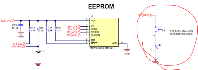

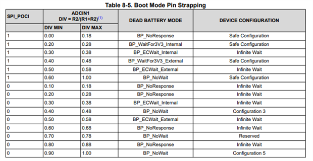

  • Eugene,
    I think you are referring to SPI_MOSI. The SPI_MOSI pin is used to boot the PD controller in safe or default configurations. So you are correct. See tables below. With identical ADCIN setting, PD will boot in safe mode if Flash is empty when SPI_MOSI is high, while PD will boot in default configuration if SPI_MOSI is low. Yes, button would be the right solution here.
    Alex

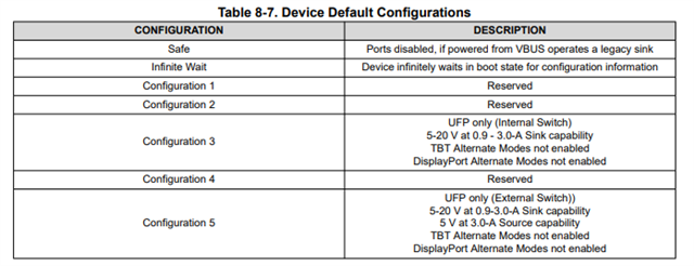

  • Hi Eugene,
    I checked internally and unfortunately, the FLxx commands for flash update do not work when PD boots in safe configuration with an empty flash. In safe configuration, TPS65987D is designed to boot while loading FW from flash. With an empty flash, PD cannot find any FW to load and is not enabled. TPS65987D is not designed to be able to load an empty flash after booting, but only to update a existing PD FW stored in flash. If flash is empty on boot, PD considers there to be no flash available, so it will expect a host EC or MCU to patch its SRAM directly using the PTCx commands.
    One thing you can try is to use the "Infinite Wait" configuration instead of the "Safe Configuration". This will put the PD in a different state at boot with empty flash that may allow the FLxx commands to work properly.

  • Hi Eugene,
    When using EVM, be careful of the ADCIN settings when using the "Disable Flash Config" button press during boot. Using the button simulates an empty flash, but also changes the ADCIN settings because it pulls down SPI pin.
    Alex
