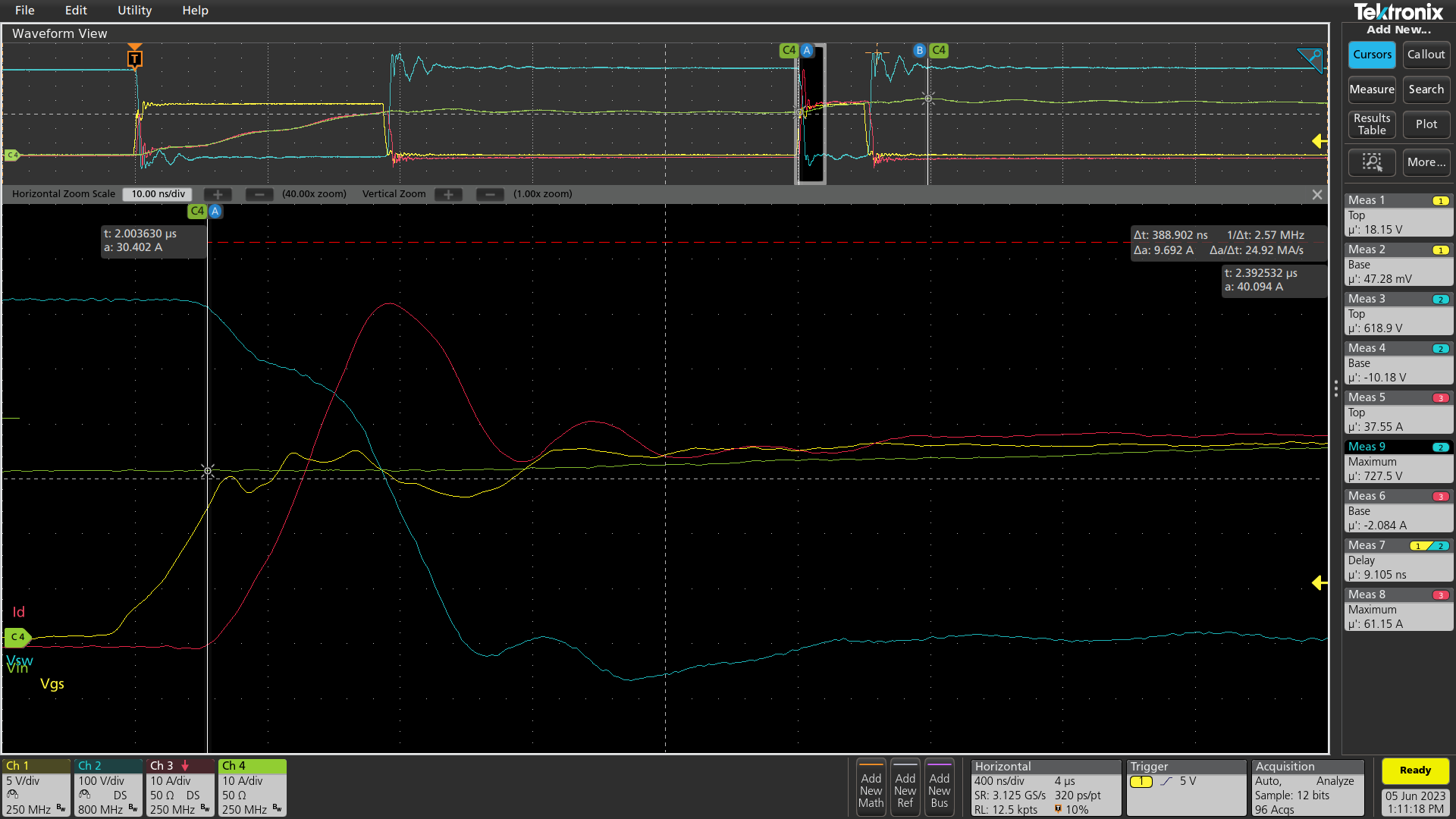

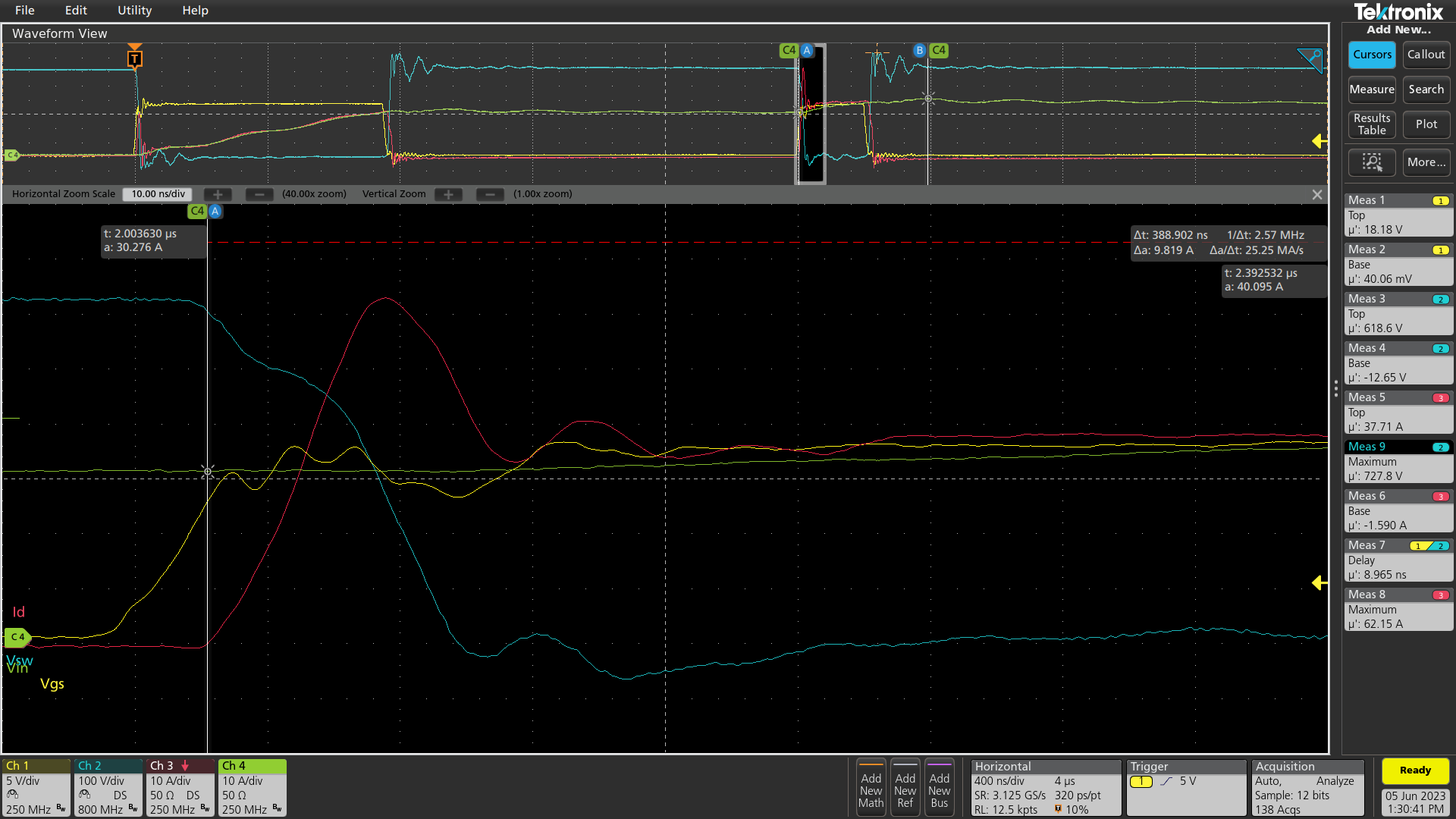

    With 400kHz, what is the expected minimum duty cycle? A 5% duty cycle will be125ns. The switching time will vary depending on your FET selection and current, but you should still have usable pulse width at this frequency and assumed minimum duty cycle. Please see some example switching times below for UCC5350 and various FETs and currents: The turn-off times are about 1/2 these turn-on times, but that doesn't eat into your usable pulse width.
    Sean
    UCC5350 driving 30A SCT3080KR in <30ns
    UCC5350 driving 2A IMZ120R350M1Hin <20ns
    UCC5350 driving 60A 3 parallel NTH4L015N065SC1 in <50ns

    In that case you should have no problem! However, the UCC5390 has 2x the output current as the UCC5350. You can use that device instead if you are concerned about rise time. I have measurements for that device also, and it is indeed a little faster, although not by 2x.
    UCC5390 driving 30A SCT3080KR in <30ns
    UCC5390 driving 2A IMZ120R350M1Hin <20ns
    UCC5390 driving 60A 3 parallel NTH4L015N065SC1 in <50ns
