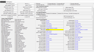

  • Hello Stefano,
    Can you provide your register values?
    Can you provide your schematic?
    Christian.
  • Hello Christian,
    atteched my default register BQ25792_Default.zip
    About the schematic, as I write in my subjet I'm using the EVB.
    Thanks and BR
    Stefano

    I removed J14 and added J21. VBUS status reports Non-standard adapter, and IINDPM is set to 2400mA
    I used standard 5V/2.4A adapter from Apple.
    In your register file, ADC(V+) and ADC(V-) read 0mV, are you able to enable these?
    In your scope capture V+/V- go up to 2.6V, then to around 1V then back up to 2.6V. Do you see the same results with all adapters
    Christian.
  • Hello Christian,
    Below my test witn Hansmann (2,4A) power supply
    - removed JP14 and added JP21
    - EN Charrge, EN auodetect, EN ADC selected, EN OTG deselected IINDPM=3250, Charge current=500mA
    - Plug in the power supply
    - VBUS Status=USB DCP 3.25A
    - ADC+D=2649mV, ADC-D=2648mV, IINDPM=3250mA
    - Do not start the charge
    My registers are saved with USB power removed, I I use a non standard 2,4Amp I see 2,6V
    This transition is performed during autodetection.
    With the J21 inserted the ILIM is not active by HW but with EN_EXTILIM I can also disable by SW ; It is correct ?
    If I enable the OTG Mode the autodetect and charge do not start; it is correct ?
    BR
    Stefano

  • Hello Stefano,
    I spoke with another team who has seen similar issue in the past, We think the issue is related to the adapters you are using. I
    I recommend using the Apple 5V/2.4A adapter, I have tested using this adapter and can confirm the BQ25792 will detect this as a non standard adapter.
    Christian.
