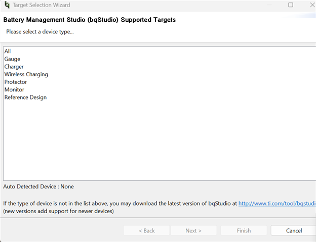

  • Hey Patrik,
    When you open BQstudio at first, can you send a screenshot of your screen.
    Like this:
    Nick Richards
  • I got it to work.  I had it connected to Port1 instead of Port2.

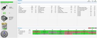

    - After that is done the learning sequence stops. It never goes through a charge and discharge from full capacity.  I have no clue why it does that.
    I start the charging and when I check the "Registers" I get the below information:
    I'm using bqSudio 1.3.125.
    What am I doing wrong?
    Is there any documentation that CLEARLY describes the proper sequence?

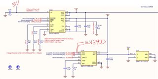

  • Hello Nick,
    I have BQ24230RGTR set to with ISET at 64mA, ILIM at 225mA and TMR at 6h 15min.
    The I2C from our MCU is disconnected and replaced by I2C from EV2400,
    The coulomb counter is a BQ27421-G1D (GPOUT is open (HiZ) during Relax since I disconnect MCU (load). GPOUT is pulled high (10k) during charge and discharge).
    BR
    -Patrik
  • Hello Patrik,
    Is there communication that are being sent to the charger so that a charge is applied to the battery? I am trying to understand if this is possibly an issue with the charger you are using.
    Nick Richards
  • No, charge and discharge current are as expected. I can see the correct levels presented by bqStudio. Charger circuit is attached.
