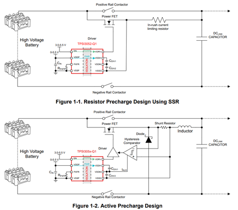

We are looking for a high voltage ideal diode ( 400V or so) solution ; Can TPSI3050 be used as an idea diode ? If so, how does it need to be configured ?
Does TI offer other solutions for this application at 400V?
  • 2- In addition to the idea diode, we need a pre-charge circuit for the DC link capacitor. Any suggestions/ recommendations will be highly appreciated
    3- Does TI recommend using SCR or MOSFET in the pre-charge circuit for this application ? ( 400V, 6000W)
  • Hello Eduardo,
    Thanks for reaching out to our team on E2E! I'm not familiar with using the TPSI305x-Q1 as an ideal diode although I can imagine it can be done. Would need some way to detect forward current and drive EN high during forward current.
    We have an active (inductive + switching) precharge solution for charging a DC link capacitor here and I'm working on releasing a passive (resistive) precharge solution.
    What are your precharge requirements (voltage, capacitance, time)?
    Tilden Chen
    Solid State Relays | Applications Engineer
  • Actually we are more interested in using a passive pre-charge solution; Can you elaborate on that solution or share some design guides ?
