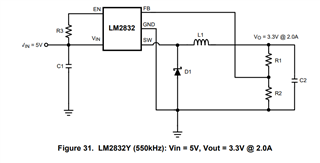

Hi team,
Could you tell how much input current would be when the output is shorted?
For example, could you explain the value in case of the schematic below?
Noriyuki Takahashi
  • Hi Noriyuki,
    When output is shorted the average input current will be around 0.8A. If this is for a new project please recommend, TPS628302 or TPS628512.

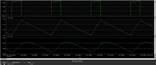

    2&3. The max value of the input current is same as the switch current limit (~3.25A) of the device. During the high side on phase of the device, VIN is connected to SW. If there is a short on the output, the inductor current will ramp to the 3.25A during the high side on phase. When the inductor current hits the current limit (~3.25A), the high side phase is turned off and the low side phase is started.
    Below is a sim of input current (I(U1:VIN)), inductor current (I(L1:IN)) and VOUT during a short. Max value of input current and inductor current is 3.48A.
    The max input current is only a transient current (during high side phase) and most of it may be supplied by the input cap close to the device. The current going through your input inductor may be lower. To be on the safe side you could look for an inductor with around 3.5A saturation current.
