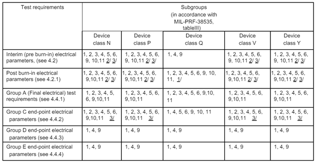

  • Hey Brian,
    There is not necessarily a linear relationship between the SYNC duty cycle and the DCL limit.
    The limit variation is a bit more than that.
    It covers subgroups 9,10, and 11 in Group A testing which are defined in the SMD.
    I would review the SMD for what tests cover things exactly.
    I can confirm I meant that the dead times subtract from the max on time.
    I would not subscribe to the linear relationship of SYNC in your equation.
    I more or less agree with it when not including the slope compensation as a part of it.
    Daniel
