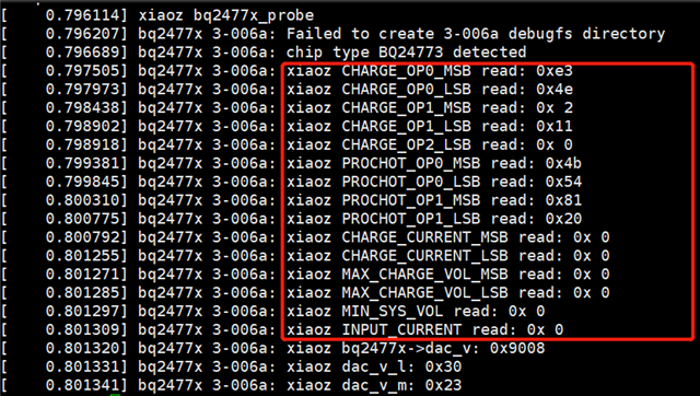

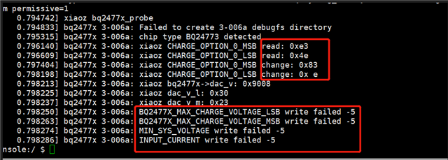

We find BQ24773 can`t write Prochot & inputcurrent register. Only could read this register.
Error as shown below.

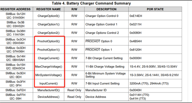

Hi Christian,
ChargeOption0(), ChargeOption1(), ChargeOption2() is ok for write to them and could read back correctly.
But ProchotOption0(), ProchotOption1() ,ChargeCurrent() ,MaxChargeVoltage(), MinSystemVoltage(), InputCurrent() can`t write to them. Meanwhile, can`t read back the correct information.
We write to them by I2C. Code as shown below:
static int bq2477x_write(struct bq2477x_chip *bq2477x,
unsigned int reg, unsigned int val)
return regmap_write(bq2477x->regmap, reg, val);
