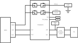

I made a device using the TPS65987D.
But I have some configuration problem.
When I connect my device it to the tablet , the Conn status is present but the Plug Orientation is unknown.
How could I solve this problem.
I programed the USBPD using the Application customization tool.
TPS65987D_TESET_00.pjt
Block Diagram of my device
    Can you provide a PD log and a register dump (preferably in Saleae)?
  • I resolved this problem by disconnecting  one of the CC_lines .
    But I have another problem , when I use the USBPD as a source it repeats hard resetting.
    Before PS_RDY message are sent the USBPD dose a hard reset.
    PD log

    Great to hear the issue is resolved.
    As for the new issue, can you check if the voltage on PPHV2 rises correctly?
