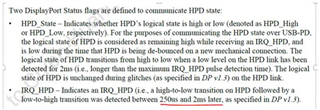

The auto-HPD/long-HPD/shaort-HPD requested per their SoC DP IP side are as below, please help to check if our TPS65987D can support it or not?
1. Long-HPD, >2ms, typically >110ms, after DP IP(SoC side) triggered, does PD controller TPS65987D hardware can detect this state? And send the message to DP TX through CC logic?
2. Short-HPD, 0.5~1ms, same process as above.
3. Auto-HPD, auto detection between above long-HPD and short-HPD states.
Thanks.

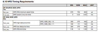

I believe what you meant is HPD_high and HPD_IRQ as these are the only message that will show up in PD log.
Below is the timing from the datasheet.
Hi Tommy,
Per below Type-C protocl spec requirements, it needs 0.25ms and 2ms later for DP Source to response IRQ_HPD, can you help to check how TPS65987 to meet this spec? Thanks a lot!
That is the t_irq_min and t_2_ms_min value in the screen shot I provided.
