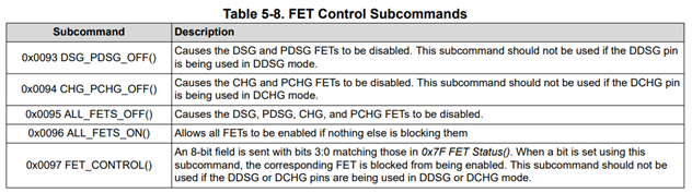

Hi team,
my customer want to control DSG FET and CHG FET independently, what operations do they need to carry out besides controlling the 0x0093 and 0x0094? the attachment is register configuration, could you give some suggestions?
