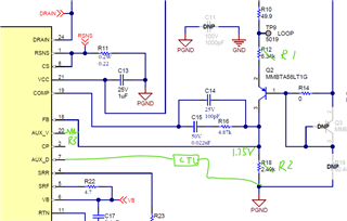

I would like to design a POE PD circuit with the TPS23755 in a Buck converter topology as proposed in the datasheet.
I already chose some components (as passive components for detection, power class and some diodes, transistors). However, for the other components, I did not find any application notes giving information for the Buck design using the TPS23755. There is only information for the Flyback application.
On the other hand, I think I found a little mistake in the datasheet : the emitter of the transistor supplying the VCC pin of the component in the Buck topology is linked to same ground reference as the RTN/GND pin of the component as on the picture attached. I think the emitter should not be linked to the ground reference to be able to supply the VCC pin.

  • Hi Benjamin,
    Thanks for your question. The buck converter is low-side switching buck (high side is a Schottky diode), so the VCC refers to the low-side DC bus.
    Please find attached reference design which may be helpful. Feel free to let us know if you have any further questions.

    For the output voltage, I would like to have a voltage near 12V so, I think that I should use a R12 resistor of  16.2 KOhms and increase the inductance to 15µH. Could you confirm my values ?
    Moreover, could I use the AUX_D input with an optocoupler and the AUX_V output to either force the voltage on the FB pin to 0V to 'stop' the DC/DC converter or command a switch circuit when a other power supply circuit with a 'higher priority' is used ?

  • Hi Benjamin,
    Thanks for your patience.
    "For the output voltage, I would like to have a voltage near 12V so, I think that I should use a R12 resistor of 16.2 KOhms and increase the inductance to 15µH. Could you confirm my values ?"
    - 16.2 kohm looks correct to me. The load current also influence the inductance value. 12uH sounds a reasonable value at 700kHz frequency and 1A output.
    "Moreover, could I use the AUX_D input with an optocoupler and the AUX_V output to either force the voltage on the FB pin to 0V to 'stop' the DC/DC converter or command a switch circuit when a other power supply circuit with a 'higher priority' is used ?"
     - It is more common to connect AUX_V with a resistor to FB. When AUX_D ties to RTN, the DC/DC has 12V output; when AUX_D is open circuit, PoE output will be low and be considered as lower priority. You can make 1.75V / (R2||R3) * R1 = 12V - 0.7V at 12V out, and 1.75V/R2*R1 = 12V - 0.7 when lower priority.

    Thank you for your feedbacks.
    I think I will need to increase the value of the inductor and of the switching frequency because, with your values, I will have a ripple current equal to about 1.13A and the circuit I am designing will consume a maximum current of 0.3-0.4 mA at 12V, so I need a ripple current near 200-300 mA.
    If my calculations are correct, I will need an inductor equal to 22µH with a switching frequency of 1.8MHz (and so a R21 resistor of 8.2 kOhms) to have a ripple current near 235mA.

  • Hi Benjamin,
    Thanks for your reply.
    I do not think the TPS23755 can work at 1.8MHz with a good frequency accuracy. It is recommended to limit the SW frequency below 800 kHz.
    Below is a inductor current waveform for 12V 0.3A output at 800kHz and 100uH inductor. You may further increase the inductance and reduce the SW frequency.

  • Hi Diang,
    Thank you for all your feedbacks, they were helpful.
    Indeed, I will use an inductor of 100µH at 700kHz (and so a current ripple near 135mA for an input voltage of 57V) to start with the first prototype and the values (the inductance and the frequency) may evolve with the tests after.
