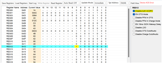

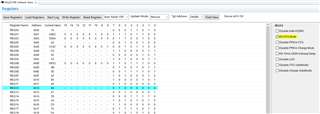

After set the EN_OTG to 1, BQ25798 did output 5V by battery discharge. But after some seconds, the EN_OTG will auto reset to 0. Is it normal?

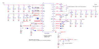

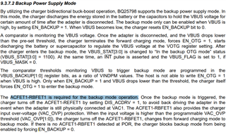

Below is my schematic. I also learn BQ25798 has a backup mode. But my schematic doesn't has RBFET and ACFET. So I can't use backup mode?
