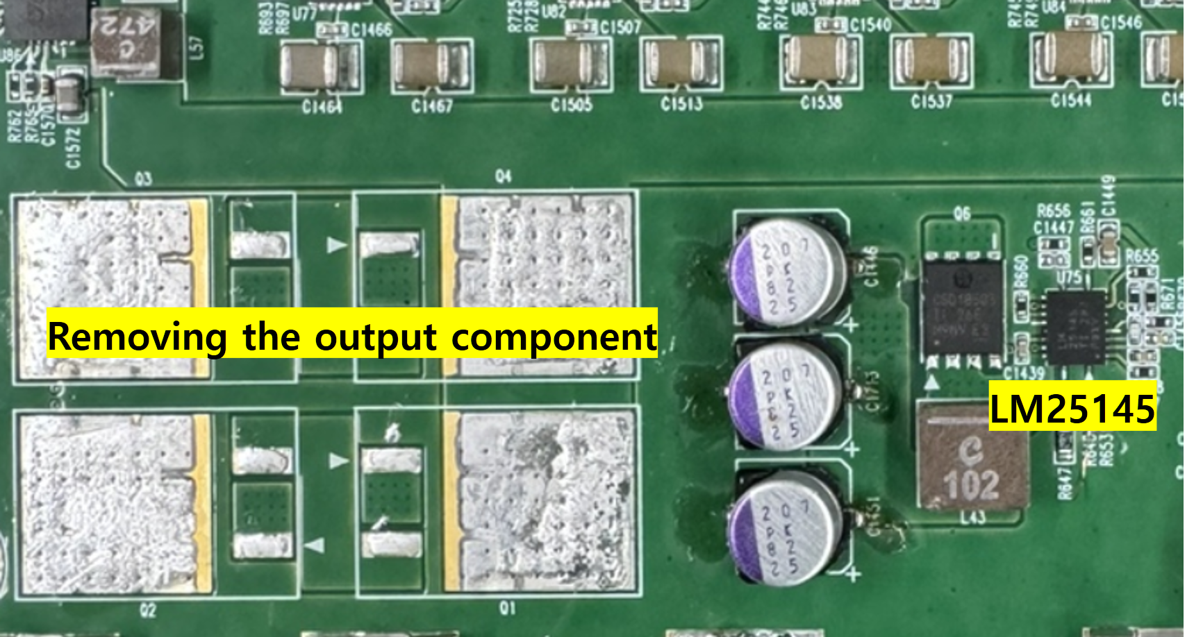

I am using LM25145 to generate a 12V output. The input voltage is from a battery (13~17V).
The LM25145 consumes around 70mA of current when there is no load on the output.
All output stage components were removed to eliminate the load.
Inquiring about the cause of power consumption when there is no load.

  • Hi Marshall_Beck,
    I measured the current of the LM25145's input (BATT_B+) voltage using a multimeter as shown in the diagram below.
    The current measured when enabled is 69mA and when disabled is 0A

    It looks like the output voltage is still active and the controller is still driving the FETs. I think the next step to test this would be to replicate the measurement in the datasheet if you are trying to understand if the behavior is expected. Some current will be required to drive the switches when the device is enabled. Are you trying to understand the behavior of the device or improve the no load input current?

  • Hi Kang,
    The LM25145 is a device that operates in FPWM mode. This means that even when there is no load, the device switches at the set frequency in order to regulate the output voltage. As a result, the device has poor light load efficiency.
    The best option to improve this would be to use a device that has PFM mode at light load. PFM provides increased efficiency at light load by modulating the switching frequency of the device. Newer controllers such as the LM25148:https://www.ti.com/product/LM25148
    Using a device that has PFM at light load will significantly improve your efficiency in this condition. I think this is the best option for significantly reducing your standby current.
